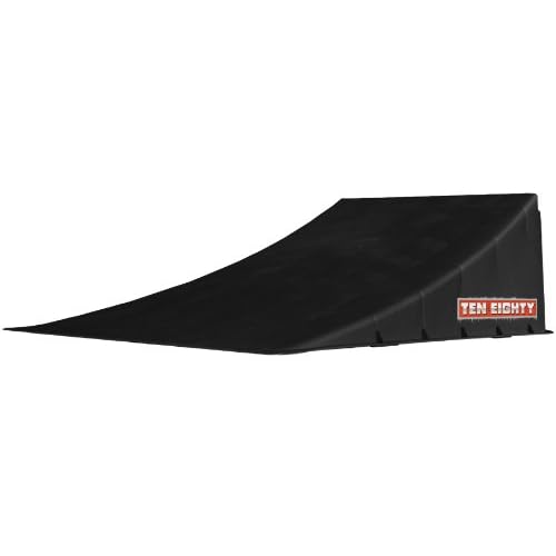

issac p
here's something a little more budget friendly. lol
im sure you could make a kicker for way less than a 100, but it obviously wont be as nice.
