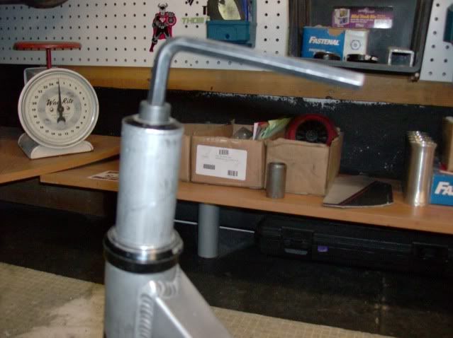

no seatpost compression sucks. Get a starnut and hammer it down close to the bottom of the fork but make it so the head of the bolt for your ics does not stick out of the bottom of the fork. Then drill out the threads in the starnut and put your bolt through. That is what I did for my old inward fork. Works perfectely.
