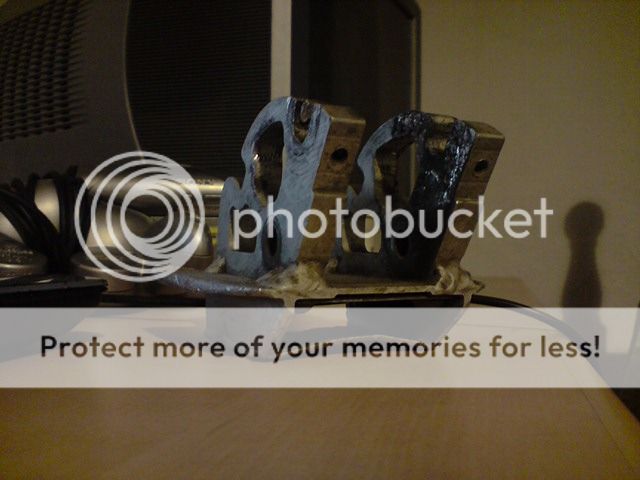

JDBen
BST Moderator
Jordan said:
JoshToy said:
jared (K) said:
question: how does the length compare to the old pro? Is the distance between the brake bolt and rear axle the same? Also, I saw in a picture of what I think was a tested prototype, it didn't have the fron four bolts that held the plates under the foldy. Will this be in the production model?
No changes in width or length, and the front plate is no longer there, the front of the deck also no longer requires the black plastic cap, they weld it closed with a plate of metal.
doesn't that just add extra weight?
i never thought that that strip really did anything, its the thickness of the dropouts that really counts.
and when you grind rails, or anything with metal coping on it, it doesn't wear the deck out that much does it? not enough to wear through the outside rails.
i am assuming it's is so that this doesn't happen:
