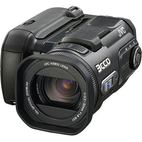

your camera ?
Eric Magray
Grant Carlin said:
i should be getting this camera :) it was either that or the d40x but its not really worth the extra money
it is worth the extra money. its the difference between point-and-shoot and DSLR. BIG difference. d40x is the cam i would get if i had money
Brian Boston
Andy [NSC said:
and i heard it comes with transmitters so u can use slaves without buying atatchments
Alot of flashes already have that, but you need one on camera (or a transmitter to one) to set the other ones off.
seankane
Andy [NSC said:
and i heard it comes with transmitters so u can use slaves without buying atatchments
i dont know about that. it could be true, but im pretty sure only the d70 only has the wireless built in, otherwise you need a transmitter.
d40x is really just more megapixels, and you won't need 10mp in most cases you won't need it.
grantcarlin
i was talking to martin and he said for what im doing (like shooting bmx and stuff) its better getting the d40. and isnt the whole point of a slave is that one flash sets of the other, but if you dont use a flash to set off another its just called a wireless flash?? if you know what i meen
P4RK3R
Grant Carlin said:
i was talking to martin and he said for what im doing (like shooting bmx and stuff) its better getting the d40. and isnt the whole point of a slave is that one flash sets of the other, but if you dont use a flash to set off another its just called a wireless flash?? if you know what i meen
nah man, canon owns. go to skateperception.com, canon owns
theres infrared, radio, and light-detecting slaves
seankane
parkrrrrr said:
Grant Carlin said:
i was talking to martin and he said for what im doing (like shooting bmx and stuff) its better getting the d40. and isnt the whole point of a slave is that one flash sets of the other, but if you dont use a flash to set off another its just called a wireless flash?? if you know what i meen
nah man, canon owns. go to skateperception.com, canon owns
theres infrared, radio, and light-detecting slaves
depends on what youre looking for. entry level, d40 is definitely better than a rebel, in my opinion. mid-level, probably better to go with 20d or 30d. high-end, noone here has to worry about.
Martin
grantcarlin
im getting one of ebay for Ã?Æ?Ã?â??Ã?¢ââ??¬Ã?¡Ã?Æ?ââ?¬Å¡Ã?â??Ã?£280 which at the current exchange rates makes it $564.086 according to my calculations
grantcarlin
NIKON D40 :D
got it today and my old flash works on it even though the guy at the shop said it wouldnt.
does anyone know whether the built in flash would trigger an optical slave flash?
P.S JAAMES STYLE SHOT <3
